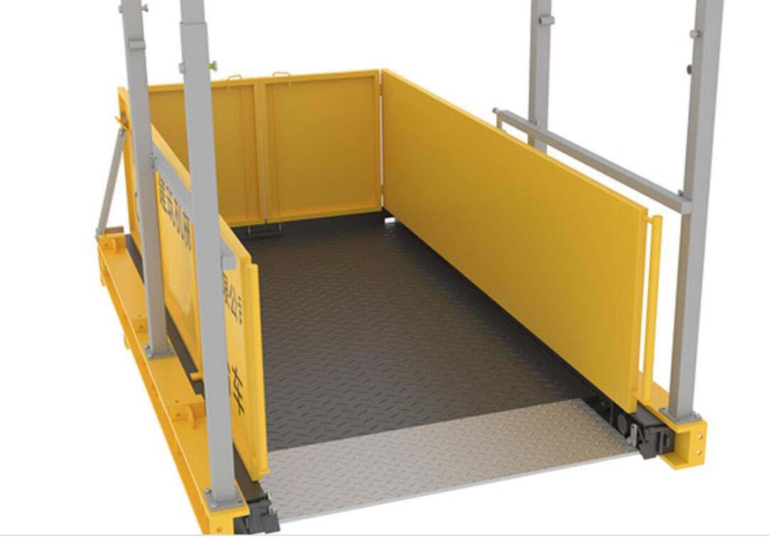

Features:
*Load Capacity 800kg-5000kg
*No Pre-embedding, No Power Required.
*Easy to Dismantle and use, Stable Installation.
FS(Manual & Retractable Type)Material Platform   Datasheet:
Overall Length
7540mm
Rated Load
5000kg
Overall Width
2350mm
Front & Rear   Support Distance
1000mm
Overhang Length
3800mm
Left & Right   Support Distance
2100mm
Size of Platform
2.7x2.24m
Dimension
7540x2350x1480mm
Guardrail Height
1200mm
Self-Weight
1360kg
